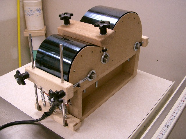

Well after weeks of reading I finially finished my side bender. It is basically a Doolin inspired side bender with a few modifications. Last night grabbed a scrap piece of wood to give it a shot. During the first bend the wood cracked. I checked out a few posts and realized that my first test piece was on the thick side (about .150). Tonight I tried another test but this time I used a test piece that was .085 thick. It worked great! Well now it is time to finish my mold and start my first build of an SJ. Thanks again to everyone for sharing information.oOLF.

awesome, are there plans available for this?
PostPosted: Wed Aug 23, 2006 1:04 pm
I like it! A lot!
I can't stand my Fox style bender. What a PITB that press screw is...
Can you give us some close-up shots of the details? I'd like to build one of those...
Thanks...

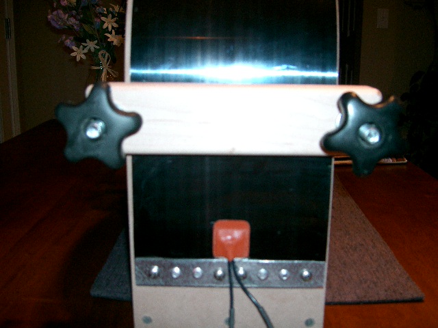

[Quote=peterm]Are you going to use a heat blanket?[/QUOTE]
I am using a heat blanket with a router speed control to control the heat. I still need to come up with a good way to measure the temperature.
[Quote=molitovv]are there plans available for this?[/QUOTE]
At this point I am still very new to this and will need to prove out the design before I post any plans.
[Quote=don williams]Can you give us some close-up shots of the details?[/QUOTE]
I will post more pics tomorrow.

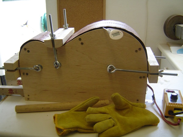

[QUOTE=Brad Way] I am using a heat blanket with a router speed control to control the heat. I still need to come up with a good way to measure the temperature.
Candy thermometer. Wally world has 'em. They measure up to about 500 degrees. Just slide the probe in next to the blanket.

Walmart also sells digiatl food thermometers for about $10 that work fine!

Brad, whats your sandwich composed of? Metal slats/blanket?
-jack handy

Nice looking bender Brad, I like the simple approach to benders and the more hands on technique they give, so that the reaction of the wood can be felt. The one modification I made to mine was to move the pivot for the upper and lower bout cauls to the centre of the 'arc' of the bout. This means that you can slide the caul round the bout giving it it's final tightening when the bout is bent, before finishing off the waist bend. Bit like this.

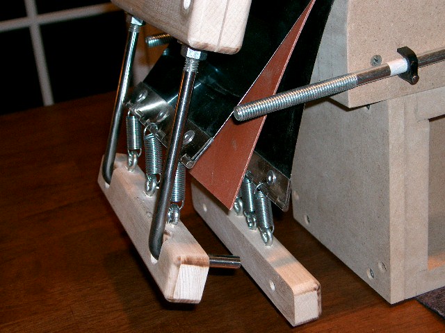

[Quote=Don Williams]Can you give us some close-up shots of the details?[/QUOTE]

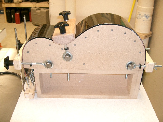

I finished a few details tonight and attached a few close ups pics of the details. I am using a heater blanket and cut a small hole in the top spring steel sheet to allow the cord to stick through on the opposite ends of the springs. It seemed to get in the way when I had the other way around (with the cord on the spring side). As for the form itself..it was made from many sheets of MDF. A few of the sheets have cut outs in the middle that allow a few eye bolts to be run up through the form to bolt the form to the base. You can see the bolts sticking through the base on the previous pictures. This basically allows the whole things to be taken appart easily and the hardware used for different forms. As for the springs...they attached to the wood blocks and both slide over the steel extension rods. When everything is put together the steel rods slide through a two holes on the front of the base. At the bottom of the holes are a few rare earth magnets that hold the rods in. This allows springs to stay tensioned even with the front hold down clamp is not tighted. Well I am sure as I learn more I will continue to make improvements but so far I am pleased with the result. Now I just to get some wood and give it a shot. Thanks again for all the good feedback!
